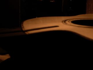

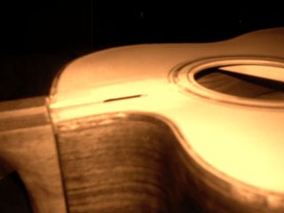

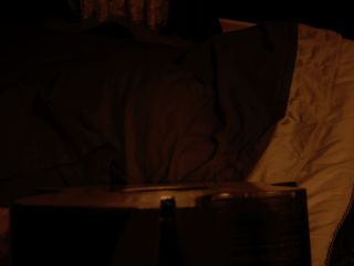

I don't think humidity did it...I think somehow I sanded the upper bout area too much with the bowl on the neck joint area...the top takes a dip toward the cutaway area...I'll post a photo in a bit...
PostPosted: Tue Jan 03, 2006 12:42 pm
Okay, here are a few pix...don't know if they captured the issue...
The angle is just bizarre...I think something at the top of the heel block must've ended up low, and I glued the top on without catching it...must've been high on LMI white!
